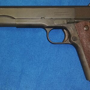

Norincos are solid guns with lots of potential as long as you keep in mind that no matter what you put into it it's always going to be a Norinco. You'll never get big money out of it so don't put big money into it.
This one got some Tussey magic sometime in it's life and it's a heck of a gun - reliable with all the ammo I've tried, great trigger, and very accurate.
